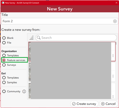

Yep, I'd definitely use a submission URL.
An easy place to start is open Connect > click + New Survey > select Feature services > locate your previously published survey > Click Create survey
That will set up the submission URL for you.
Doing this doesn't copy over formatting though, so I generally do one of the following to get me to the starting-block:
  • Copy-paste the contents of the surveys and choices tab from the original into the new XLSX; or
  • Make a copy of the original XLSX > paste in the contents of the settings tab from the new XLSX > replace the new XLSX with this modified copy.
