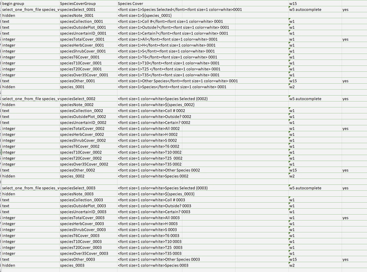

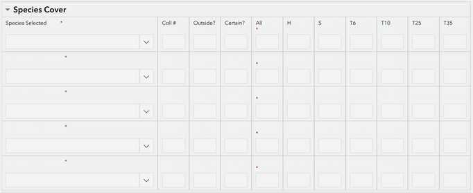

ChipMorgan65
I've gotten this far with manually configuring the XLSForm. I think the form is usable, but am definitely not going to build 100+ rows by hand.
This is what the XLSForm looks like for the first three rows:
