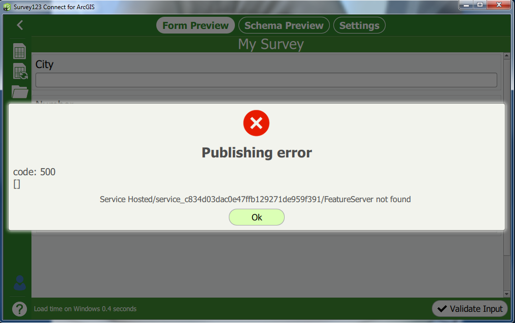

I cannot publish surveys to portal, always get error "Code: 500 - Service Hosted/service_xxxxxxxx/FeatureServer not found".

I am using Portal 10.4.1 and Survey123Connect 1.9.24.  This happens every time.
I created a new form with three fields, a text, a decimal and a geopoint.  This is the message:

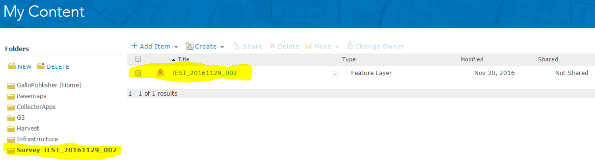

It seems the folder is created in Portal with a single item as the feature layer:

If you check in ArcGIS Server manager > Services > Hosted, is the mentioned feature service listed there?

  2. No entries at all in the log files
  3. Feature service is listed under Hosted Services with status "started", however, the only button enabled is the "delete"; "start" and "stop" are disabled.
