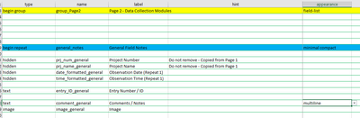

Which version of Survey123 Connect and the Survey123 Field App are you using?  After specifying a value of 'multiline predictivetext' in the appearance column of a text question and publishing your survey, you should see both the multiline appearance and predictive text enabled on your Android device.
I confirmed this behavior to be working when publishing a survey using Survey123 Connect v. 3.1.126 and Survey123 Field App v.3.1.159 on a Samsung Galaxy S8 with Android 8.0.

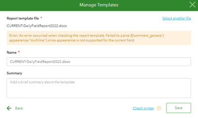

Hi @BrandonArmstrong ( @Anonymous User ) - This value works fine in S123 connect and the field app behaves as expected, but my feature reports fail to generate when I make this change. The error message says something along the line of:   "appearance" cannot be found for ${comment_general | appearance:"multiline"}
Is this a known bug/limitation?

EDIT for posterity: This was confirmed as a bug (BUG-000146779), but using "predictivetext multiline" in the appearance column (instead of "multiline predictivetext") does work. While troubleshooting, we noticed that "multiline predictivetext" will work if it's present when the survey is first published, but not if it's changed after first publishing.
Just for the sake of continuity here...
This works fine, both in-app and in the feature report:
The portion of the feature report that prints out this response:
If I change it to multiline predictivetext and republish, the in-app behavior works as expected:
New records and existing records fail to generate with this error though:
And I start getting a syntax error when trying to upload an edited feature report (with appearance:multiline still set):
