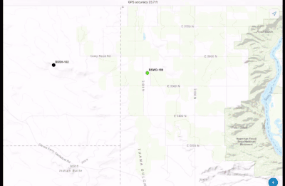

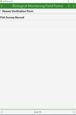

I have a feature layer containing points for biological monitoring sites. My survey is split into multiple pages for each type of data collected during the visit, with each page being a separate repeat. I need each page to have a repeat_count of 1. If I use inbox, the repeat cannot be opened (see screenshot #1). If I use collect, the repeat_count of 1 works as intended (see screenshot #2).
Can anyone tell me how I can have a repeat count of 1 but still use Inbox? I'm hesitant to use the trick where people use Field Maps to click a link to open a new survey with data prepopulated, as the user will need to view more than 40 different attributes from the site in the survey.
