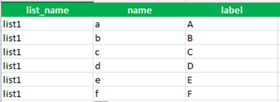

Step 1: Concatenate the names and labels in variable
  • Create two variable (name_list, label_list), in the calculation Field, use the excel TEXTJOIN function to concatenate the values in the "choices" worksheet with commas, and encapsulate the concatenation with '.
  • Be careful, the list should be the same size.
  • Make sure that the names and labels do not contain commas or quote marks
  • Set the bind::esri:fieldType to null
=CONCAT("'", TEXTJOIN(",", TRUE, choices!B2:B7), "'")
