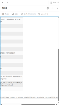

FSD_Main
No none of the fields have arcade expressions and I have a field in the attributes table that lists the Z values the field name is Z. What i meant in regards to that sentence was that within the pop up for the MH layer the url calls out those attributes i'm trying to obtain. not sure you can see this screen shot well but i can't extend the pop out anymore than it already is.
But if the formatting looks correct and i know those fields are a text and integer field and those aren't being sent through a repeat.... so I'll keep digging. otherwise I'll just default to a .csv file i guess.
