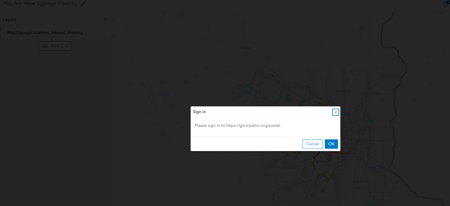

This is the screen we should be seeing-
Could someone please let us know if this is a known bug?

In Organization Settings for both, is the order Logins in the same order?  It looks like in your video (from ArcGIS Online?), the user is being prompted for username and password (not SSO), and in the web map screenshot (I'm guessing is from the portal web map?), the user is being prompted for SSO log in.
I'm not a distributed collaboration expert, but if the logins order is the same, is that layer shared/collaborated with ArcGIS Online with the credentials included? (This may not matter since it seems like you're expecting to be prompted to log in, but the login GUI is different than expected - please correct me if I'm misunderstanding).

The web map is in ArcGIS Online, only the data is coming from enterprise and is collaborated using the Distributed Collaboration method not stored credentials method.
Typically when using Distributed Collaboration and the data is coming from Enterprise there's a message like my second screenshot that allows you to authenticate with portal. Since we're also using SSO, clicking "yes" passes our authentication/token.
Hopefully that clarifies a little more.
