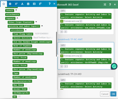

Hello to the community! I am currently exploring the power of webhook using the integromat in survey 123 and put every values in a MS excel. I am currently stuck in how to collect all data from a repeat function and placed it in  an specified cell. I am always getting the first repeat.
Anyone could help me out about this is much appreciated.

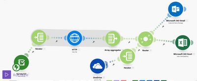

So all of that functionality is possible currently.  Below is the scenario as I have it set, using a Router tool to handle multiple tasks simultaneously.

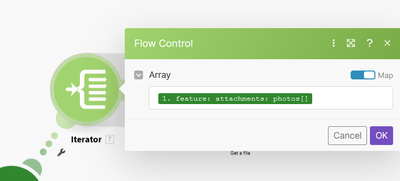

The iterator can take your photo attachments:

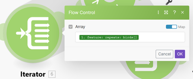

Or repeats (in this case the repeat section is named "birds"):

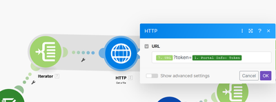

For photos, you need to use the HTTP module because they are held in a URL, which now you will get from the Iterator, NOT from the Survey123 module.  Notice the dynamic text is colour coded to keep track of the source.  Also, not sure if it is needed, but I saw a reference in other online content to adding an access token, so I include this just in case (the URL is from the iterator and the token from Survey123, and "?token" is typed in by hand:

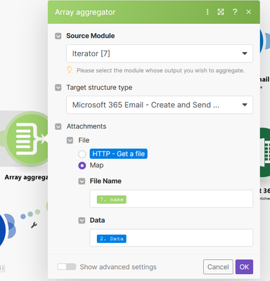

So this now gets each of the photos from the survey entry... but if we now sent that to an email module, we would get an email for each attachment.  To avoid this, I then use an array aggregator, which then combines the photos back into a single array to be included as an attachment in an email:
JamesSerendip1_4-1675716624970.pngThe names come from the aggregator, and the data comes from the http module.  Note, for some uses you may want to get creative with the "name" section so you will be able to identify these files later.

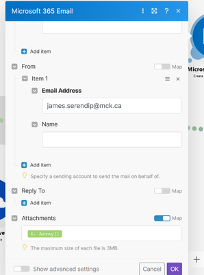

Now this is ready to send to the email module.  I use Microsoft365Email.  The only trick here is to set the attachment section of the email to map to the array from the  aggregator using dynamic text:

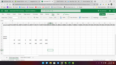

For this scenario, there were no repeats in the data, so I can go right into the Excel module as well.  For this to work, you need to FIRST create an Excel online workbook.  It is easiest if the field names match the field names in Surve123 (if you are working with a Survey that is already published, or even already has data in it, go to the Survey123 website, open the data section, and export Excel, then just save that to your online platform!)

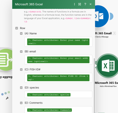

Then, just use dynamic text to match the Survey field names to your spreadsheet names.  Note you can select different sheets, so you can have new sheets for each calendar year, for instance, and would just need to reset the designated sheet here annually.

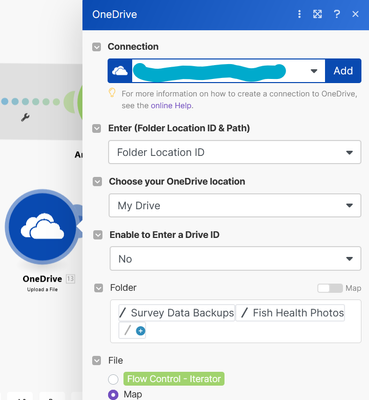

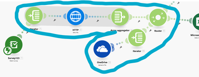

To get the photos to back up to a folder in OneDrive, I had to split them BACK UP, so after aggregating them into an array, I once again broke them down with an iterator (more skilled users may find a way to do this earlier on without all these steps, but I tried and couldn't make that work for me).
This way it will save each photo individually, and each photo can be named individually!
The OneDrive module requires setting up your folder location etc.  Here too, I just made the folder in advance, though there are modules for making new folders too.
