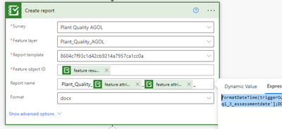

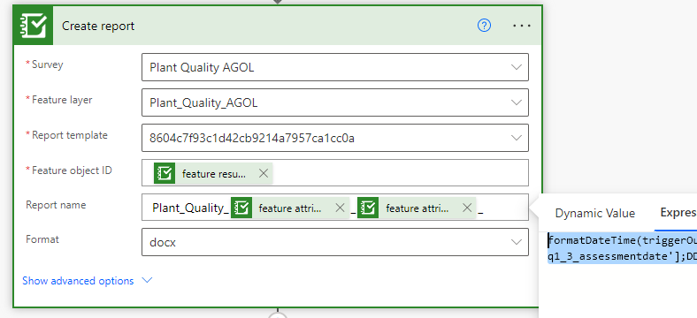

In the "Create Report" section, I am giving the report a unique name using fields from the survey. I want to add the date to the name as well, but am struggling to get the formatting right. I know that I have to use the formatDateTime() expression, but I am just not able to get the syntax correct. My date filed in my survey is called q1_3_assessmentdate. I have tried using the following but it isn't working:
formatDateTime(triggerOutputs()?['body/feature/attributes/q1_3_assessmentdate'];DDMMYYYY)
Previously, in Integromat, I used to format it like below:
Please could someone explain to me how i format the date properly. I am not interested in the time at all, just the date

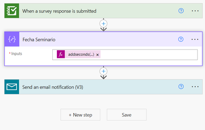

Here's how I did it:
Fecha Seminario is the Compose data operation, and the formula is:
addseconds('1970-1-1', Div(triggerOutputs()?['body/feature/attributes/seminar_date'],1000) , 'dd-MM-yyyy')
Then, on the Send an email notification step, I used the output date from the compose operation. I hope this works for you.

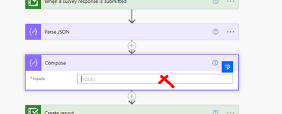

  1. Start by adding a "Parse JSON" action to your Power Automate flow. This action will parse the survey response and extract the date field that you want to format. Make sure to select the "Date" data type for the date field.
  2. Next, add a "Compose" action to your flow. This action will use the formatDateTime function to format the date in the desired format. In the "Inputs" field of the "Compose" action, enter the following expression:
formatDateTime(triggerBody()?['Date'], 'dd/MM/yyyy')
Replace "triggerBody()" with the name of the output from your "Parse JSON" action, and replace "Date" with the name of the field that contains the date you want to format.
  1. Finally, add the "Compose" action output to your report. You can do this by selecting the "Compose" action from the "Dynamic content" pane and choosing the "Formatted value" output.
With these steps, you should be able to format the date from the survey response to display it as DD/MM/YYYY in your Power Automate report.

Please could you be more specific in what Dynamic Values or Expressions we have to use in the Parse JSON action. It asks for Content and Schema. I am not too sure what to do there to make it work
After you have done this, what Inputs do you use in the Compose action? Is this where you add formatDateTime(triggerBody()?['Date'], 'dd/MM/yyyy') and replace the portions as explained in your answer?
