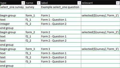

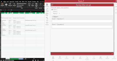

What I would like to do is have the user select which survey they need to fill in and have it go to that particular part of the survey,
You can do that all within a single survey, which may be the best option. Have a select_one or select_multiple be the trigger. Then use that field to modify the single survey to look the appropriate way (using the [relevant] column). Here is a quick example (hopefully its legible):
