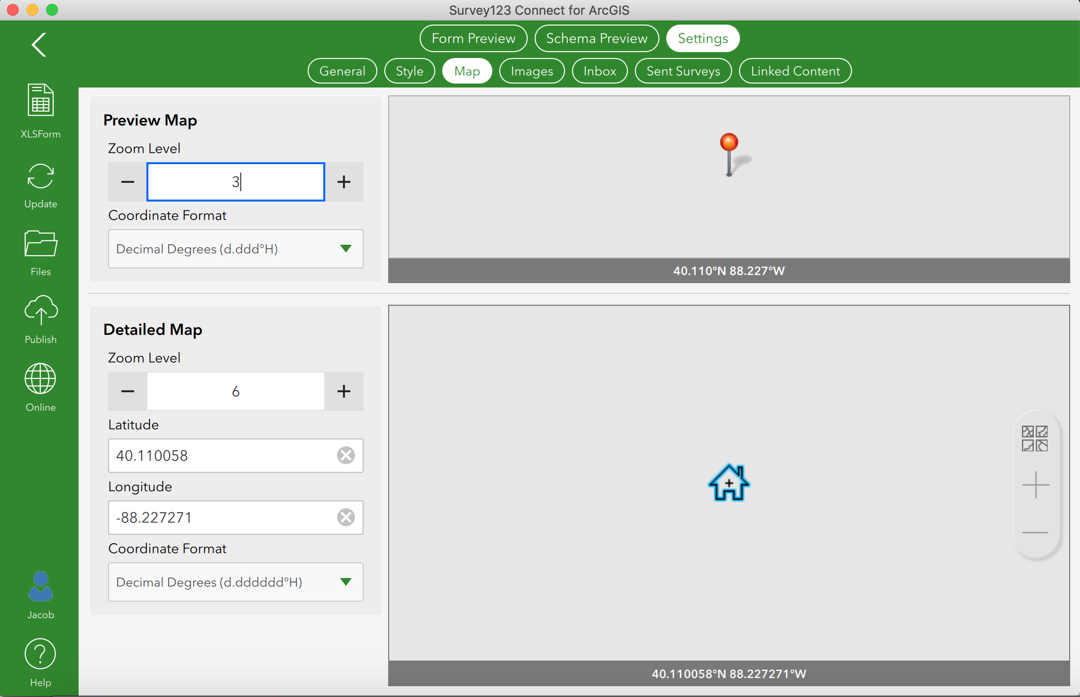

In the survey123 Connect Application, I would like to set the default location for the GeoPoint field. I have the latitude and longitude of the default location and I have entered it under the Map tab under Settings. This is shown in the attached image. Map Default Coordinates and Zoom Level
However, It doesn't update the map shown for the question using the GeoPoint field in the final published survey. (I published it after saving the changes in the Settings). Would you suggest any other changes that I can try?

Hi Jacob,
This should work as expected when you click the Home button in the geopoint question map. The one you set in Connect should reflect the default home location when you open the map. What version of Connect are you using to publish the survey? Do you set a default value in the xls form? How did you open the survey, from field app or web form?

I am using survey123 connect 3.6.137 for designing the survey. The users open the survey on their browsers.
Thank you for pointing it out that it shows the default location when the home button is pressed. Before that, when the map is initially loaded, it shows another location.
I have set the default location on the survey123 connect application (as shown in the figure in my original question).

Hi Jocob,
As we had fixed issues regarding the basemap/location between Connect and webform, I will encourage you to use the latest vewrsion of Connect to publish the survey to avoid any map related issue.
If upgrading of Connect or republish is not possible at this moment, you may want to try to set the webform version to the latest one by going to survey123 web>survey>Settings>Versions>choose "Always use the latest version." and save the change to see if that would make a difference.
