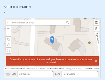

ahargreaves_FW
@JamesTedrick as posted here I opted to simply use the "&center=<lat>,<long>" option. This works to place the point on the correct location on the map within a survey. However, the warning message shown below pops up after a few seconds unnerving the user. Is there a way to suppress this somehow? (my Geopoint must remain editable so the user can fine tune the location)
