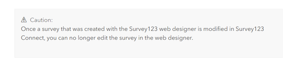

I am looking for a way to edit a form created in Survey123 Connect using the Web Designer. I know this is not normally allowed because of different capabilities, but, is there any way to do that short of recreating the form(s) from scratch? I am hoping to get around some recent technical issues with remote work (they are on my side, not ESRI's) and use the Web Designer more. I like the access to bells and whistles though, so almost all of my forms were created with Connect. I can remove unsupported capabilities and change things around if needed, as long as I can use the web designer to edit moving forward.
Any advice/solutions that are not completely recreating the form in Web Designer (and moving the data into the newly created Feature Service, etc.) are appreciated. Thank you.

Hi @BrandonA_CDPH ,
If you have to create in Web Designer, you need to start from Scratch. Please see the documentation below:
https://doc.arcgis.com/en/survey123/browser/create-surveys/publishsurvey.htm

BrandonA_CDPH
Exactly what I was afraid of.  Thank you for verifying that I didn't miss something.
