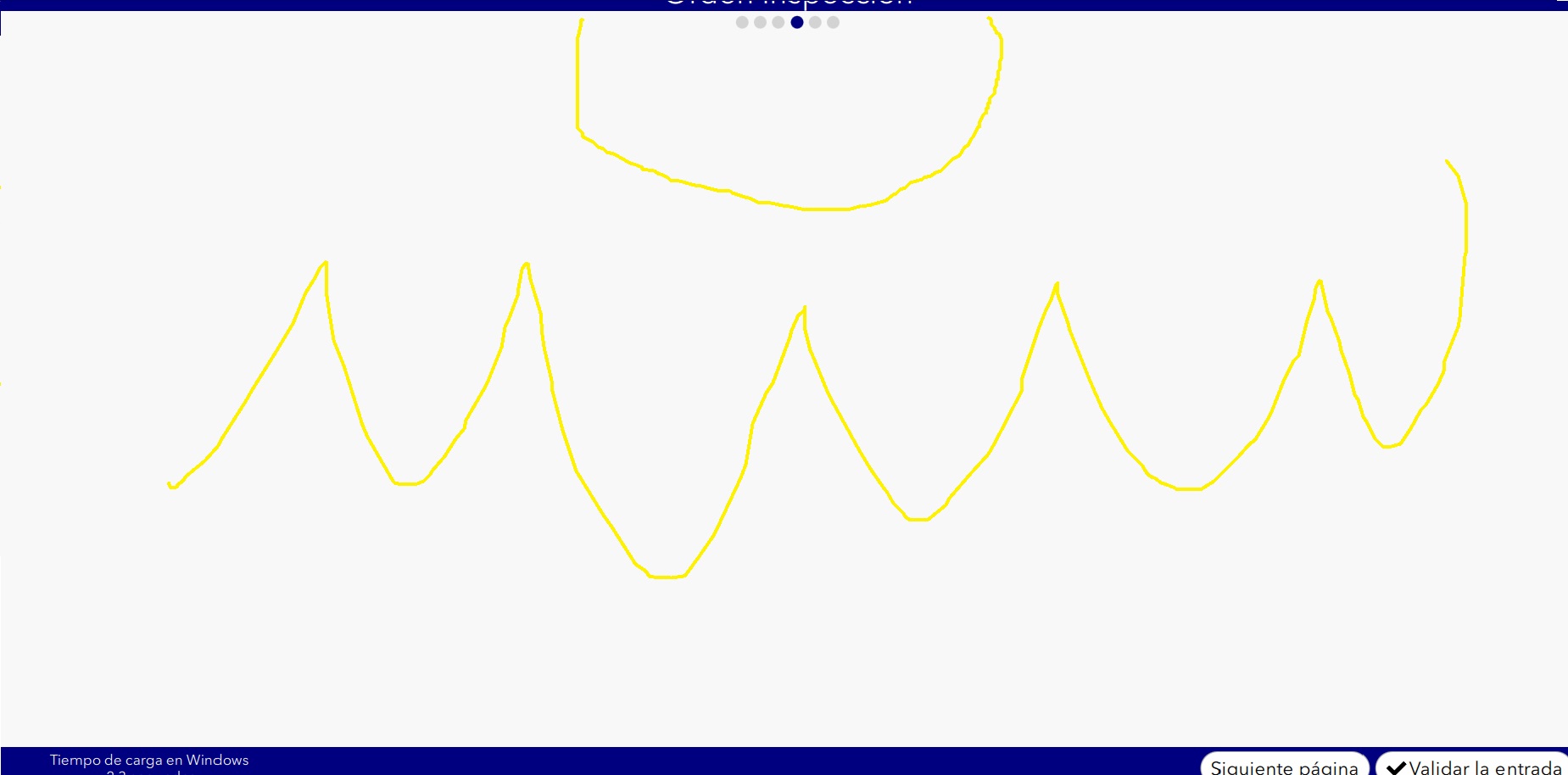

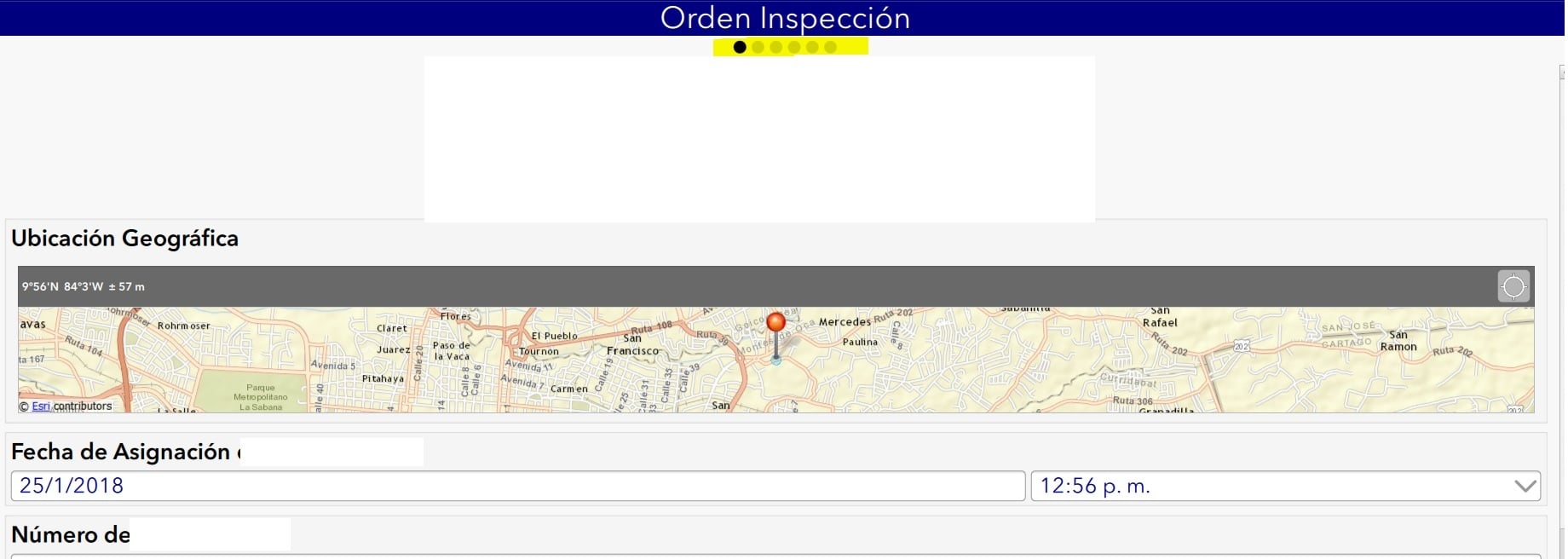

I've been working in one survey Form with Connect. My actual issue is when I use a #relevant expression in a Group. The normal expected behavior is that the "different pages (groups) with the relevant conditional did not appear" but looks like that has another behavior. ( See image 1)
Example
See the highlighted zone this is the first group. then I ask if can continue with the full form ( because the person can have difficulties when arrives to the site).
Example2
But look like when the person say "no" the pages are already created.
form with no information
So the page is already created without information. How can I avoid this? Thanks.
See you around!!
JamesTedrick
Esri Esteemed Contributor
Hi Roger,
This is a known issue with the pages functionality- it will create a page for the group even when non-relevant.
