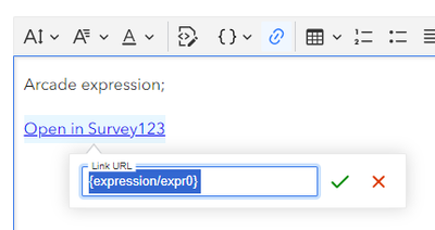

You use the custom popup and then the URL button like this.  This is Map Viewer Classic but same concept in new map viewer.
I only create new features not edit.  To edit yes you would need the globalid also.  I think you can add this by using Arcade to just get the globlalid and add that to the URL using {expression/expr0} notation.
I do that a lot since I need to call from the child to the parent to get a number of fields I need that I then send to the form.
arcgis-survey123://?itemID=38e3353292dsfsdfsdfcb121a6&field:PointID={PointID}&field:EvaluationID={expression/expr0}&field:DesignLat={expression/expr6}&callback=https://fieldmaps.arcgis.app
