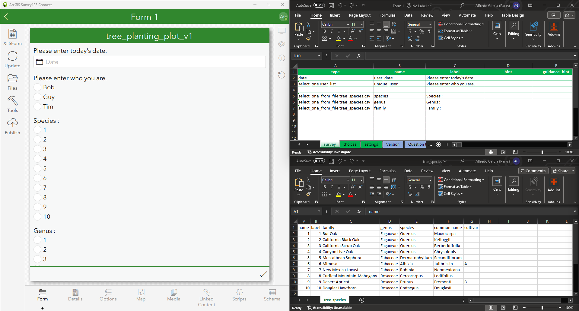

I'm using Survey123 connect, I've attached my form and reference .csv.
I've followed the steps in this post but am still receiving the incorrect return on the form (screenshot attached).
I bet it's something simple, I just can't quite get a grasp on it. Thanks for any help!

I am sharing the blog post for the solution to the problem.
Survey123 Tricks of the Trade: External choice lists

The lists always display the label column and store the name column.
