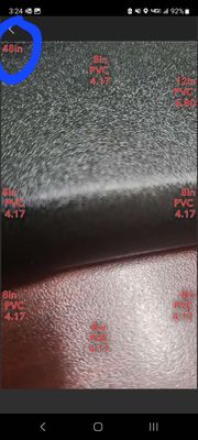

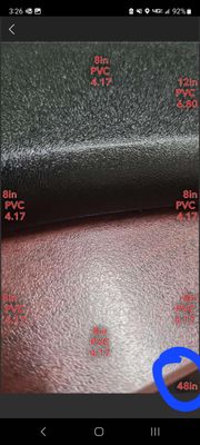

Hi there can anyone help me with a formatting issue when I include the '&margin' option. My watermarks show up as expected with all of my formatting options until I include the margin. As soon as I enter "&margin=5" the watermark moves from its original topLeft position and defaults to the bottomRight.See photos:
Code
without marginwithout marginwith marginwith margin
Result
without marginwithout margin           with marginwith margin
Any help appreciated, thanks

I am also encountering this issue!
