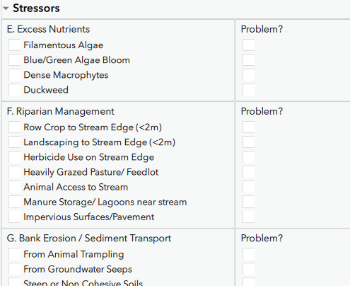

What you really want is to grow a repeat down the page which is asked for a lot.  See this recent post with links to upvote the idea.  https://community.esri.com/t5/arcgis-survey123-questions/create-a-table-or-question-with-multiple-te...
I have ran into this several times and basically 3 options for now.
Select multiple and use post processing to arcade as I posted.
Create one field per option and then post process into a table.  The users like this cause its fast and easy.  The code is long but easy (I can post if you like).
Or use a repeat and slow the user down.  Some forms its not bad and some it triples the taps.
I have used all 3 at different times.  On yours I am not sure how you will keep Problem and the value lined up though.  Unless you named it somehow.

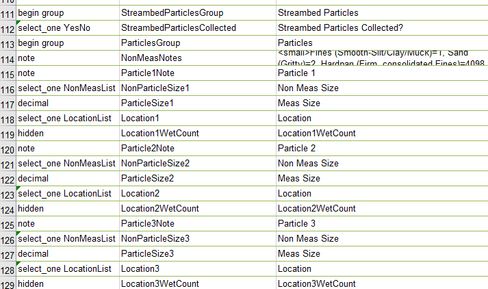

Ok here is a sample of one I did with a bunch of fields.  Crew like the speed of it. It starts at 10 but can grow to 15.  It does mean 45+ extra fields which slowed the form load down but users do not mind that.
In Connect it looks like this all written out
Then in Python I use insert cursors to split it back out into rows and all into the same table with one set of column names.  Again it looks long but its easy cause you can just copy paste each Particle and change the number.
