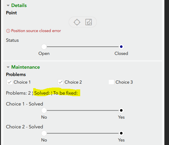

Hi,
I've created a calculation that counts how many problems are solved.
  1. - Problems are first selected from a multiple selection question. Every problem, if selected is =1 in a hidden question. the sum of all of them gives me the "Problem = number"
  2. When the problem is selected a question: "it has been solved" comes up: if answered yes, an hidden question collects =1 and they are summed up. Solved = number
  3. A calculation Problems - Solved = to be fixed
  4. this I know how many problems I have, how many fixed or not

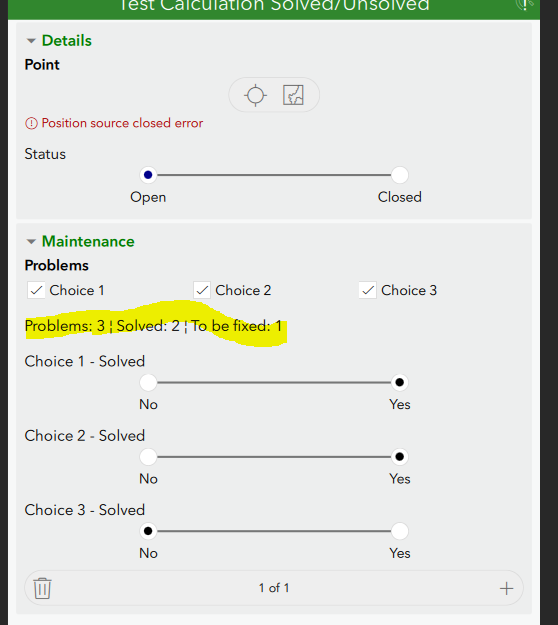

It works perfectly if all my 3 problems are selected, if I select only one or two the calculation doesn't work: solved and to be fixed are empty.
this is a repeat table. By default all values are set to 0 {es.= if(selected(${Problem},'Choice_1'),1,0)}, can't understand why the value Solved and To be fixed is empty
Thanks!

That makes more sense but it still wont work.
It is because all select one must be string.  So even though you give it a 0 and 1 it is really "0" and "1".  123 tries to help you when all three are filled out and gifts you the conversion.  This will prob not work at all on the web.
Best thing is to make a second set of if(value, 1, 0) and then count those just like you do for Choice_T.  I think it is the best way.  int("") is what is causing the non calc.
Other option that may work is to use coalesce("", 0) and put that inside the int.  Then it should give you 0 if it is sitting on blank.
Hope that helps
PanGIS
Thank you!!! this  solution worked, and it is amazing.
