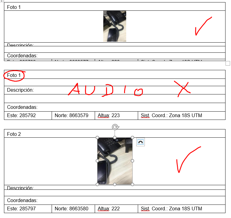

Hello,
I am trying to create a report from survey123, the survey I use is a repetition type to take photo and audio at the same time. So I have cases like these.
         repeat 1> photo
         Repeat 2> audio
         repeat 3> photo and audio
         repeat 4> photo
         repeat 5> photo and audio
When using my template, I have two lists, one of photos that I would have to have a continuous enumeration (Photo 01, Photo 02, Photo 03, Photo 04) and another one of audio (audio 01, audio 02 and audio 03) , but the values are doubling each time one of these is empty.
Could you help me by explaining what kind of sentence I can introduce to stop duplicating the photo and audio values.
I enclose my survey, template and my result
Thank you
JamesTedrick
Esri Esteemed Contributor
Hi Jorge,
It looks like you would want to use conditional statements to determine if a photo or audio segment was submitted for a give repeat.  You can use ${q|getValue:"name"} or one of the hidden questions to check to see if an attachment exists for a given question and use that in an ${if } {/} statement.  An initial guess would be
${if Confoto='true'} {/}
To display information when only a photo is present.
