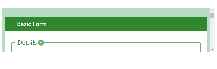

I have managed to embed a Survey123 web form within a web page according to the instructions here.
It all works except the height of the embedded form is too small - see below. I really want the form to display at full height and not have to scroll through the form using the scrollbar. I cannot find any way to adjust the height.
Can anyone help? Thanks in advance.
2022-08-11 08_05_48-Test Survey123 web form integration _ Tamworth Regional Council.png
ZacharySutherby
Hello @AdrianDoss
The height would be controlled by the <div> container you embedded the Survey123 webform in. If you increase the height of the CSS class assigned to your <div> tag that should increase the size of the Survey123 form.
