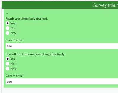

DougBrowning
MVP Esteemed Contributor
See attached.  It works fine.  You are not creating your if statements correctly.
Also there is no need for 3 different comment fields.  The schema will be horrible to use.
I also removed the font color since if you have the background and the text the same color you cannot see it. See below
The attached is much simpler and works.  Hope that helps

DougBrowning
