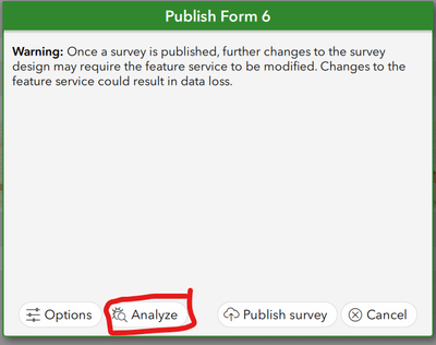

In connect when you make changes to your xlsx are there any warnings? Also,before you publish did you "Analyze" the xlsx form?
If not you should run that and address as many of the items as possible.
