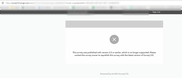

I created a new survey using Connect 3.19.116 and I was able to submit the survey. Then, I was about to test it using URL parameter with globalId and Copy mode. However, it throws this error (see the image below).
This survey was published with version 2.5 or earlier, which is no longer supported. Please contact the survey owner to republish this survey with the latest version of Survey123.

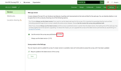

Out of curiosity, what does it say on your Surveys Site for the version (check screen cap below):
And if you are able to, attaching the XLSX to your post would help. If it is confidential, I'd suggest contacting Esri Support directly.

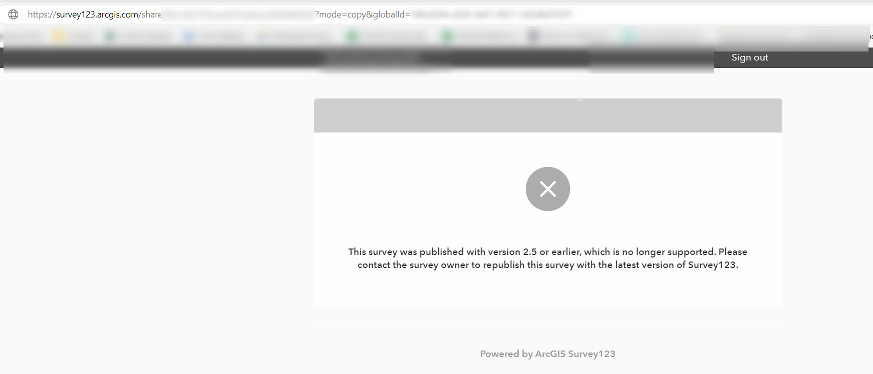

I am getting the same issue with a form version 3.23.
I had jr:choice-name in the survey but have since removed it and also am using the field-list appearance.
Did you ever figure out the resolution? I am also going to rebuild the survey line by line, and will report back if I notice anything/get different results.

I was able to get it to work after selecting this setting:
I think it stems from using jr:choice-name and then later removing it, but this is sort of a wild and irresponsible hunch.
