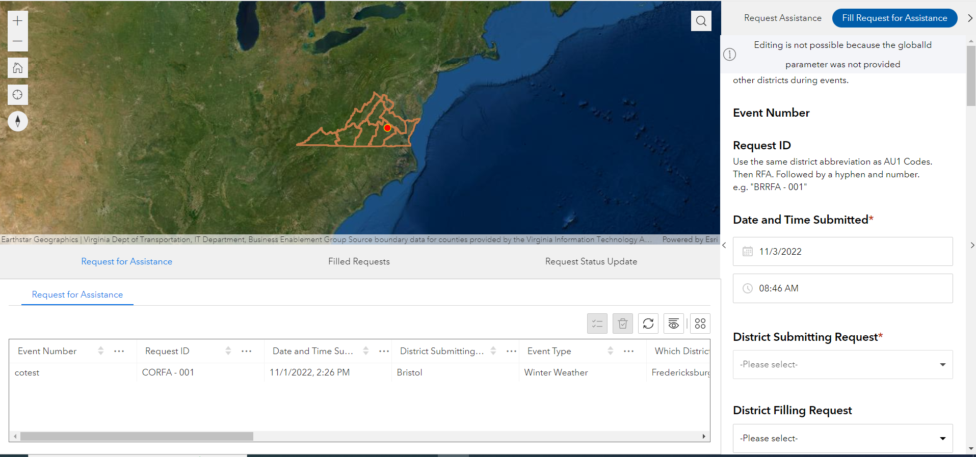

I am using experience builder to develop out a request for assitance process. The requests are being submitted using survey123. I am using a second survey to capture the information for the group filling the request. How ever I am getting a global ID error message. I'm not sure how to go about fixing this since the surveys are being used within experience builder instead of a dashboard. How do I fix the global id error for my second survey so that the feature layer can be edited?

Survey123 needs the globalId of the records that is trying to be edited to be passed along via a URL parameter, when using Experience Builder that is done through selecting the layer or view from the Map widget. Please see this documentation link for more information.
