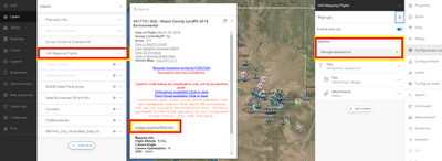

1. In your web map, select the polygon layer, "configure pop-ups", and then "manage expressions"
2. You'll see a window like this:

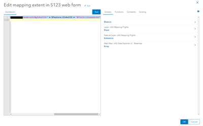

Edit this Arcade Expression to suite your needs and save it:
var urlLink = 'https://survey123.arcgis.com/share/SURVEY-ITEM-ID-HERE?field:FIELDNAME1=' + $feature.Field1 + '&field:FIELDNAME2=' + $feature.Field2
return urlLink
(If you click "test" at the top of the screen, you can try it out and then copy and paste it into a new window to make sure you set it up correctly. )
3. Use the Arcade Expression that you just setup & saved in your feature's popup:
