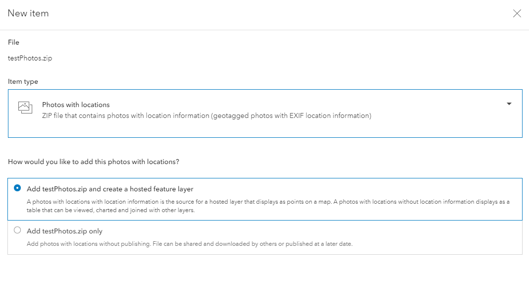

I tested creating a feature layer from survey photos (below) but it generated an empty point layer. It looked like the photos did not include any x, y information.

ChrisRoberts2
Hi Kerry
The exif (GPS) information should come across with the photo when you export it.  If you look at the Properties and the Details tab of the photo, you will see the Lats and Longs.
It is possible to  write a python script to batch export attached photos to a folder.
You can then use the GeoTagged Photos To Points tool in arcgis pro to create a point feature class of those photos.
I just tested this with some photos from one of my surveys and it worked.
If the exif is empty as you suggested in your post, and you using iOS, you might need to check your photo format settings as I described.
Cheers, Chris
