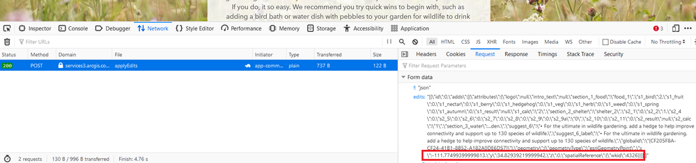

I added a point in your live survey in an attempt to reproduce the problem you are describing. I could not reproduce the problem. As shown in the screenshot below, the developer tools in the web browser indicate that the point geometry is sent correctly.
I believe the problem here is that users may not be providing a location when completing the form. You could make your geopoint question required to avoid this.
In a second test, I was able to send the form after answering 'Yes' to Are you happy for us to plot your garden on a public map to show wildlife gardens in Surrey?, while leaving the map question empty.   In that case, you would expect the user to enter a location, but if the map question is left unanswered, the geopoint value will be null (as expected). Again, making the geopoint question required should avoid this situation.
