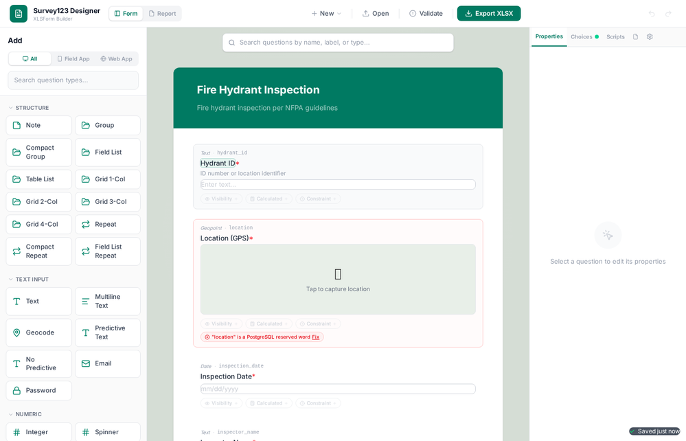

I'm a longtime Survey123 user and I wanted to share a personal project I've been tinkering with. As someone who spends a lot of time building XLSForms in Excel, I started wondering what a visual, drag-and-drop form builder might look like if it ran entirely in the browser with no login required.
The result is Survey123 Designer, an open-source tool that lets you visually build XLSForm surveys and export them as .xlsx files ready for Survey123 Connect. The big thing for me is that it supports the full XLSForm specification, including all the Esri extension columns (body, bind, parameters, etc.). Every column you'd normally hand-type in Excel is exposed through a visual property editor, so you get full control without memorizing column names.
It runs 100% client-side (nothing is uploaded anywhere), and it's hosted on GitHub Pages.

Drag-and-drop form building with 69 appearance-specific question cards across 9 categories. You drag a card (like "Spinner" or "Likert Scale") onto the canvas and it creates the right type + appearance combination automatically.
Three-column layout: question palette, form canvas, and properties panel

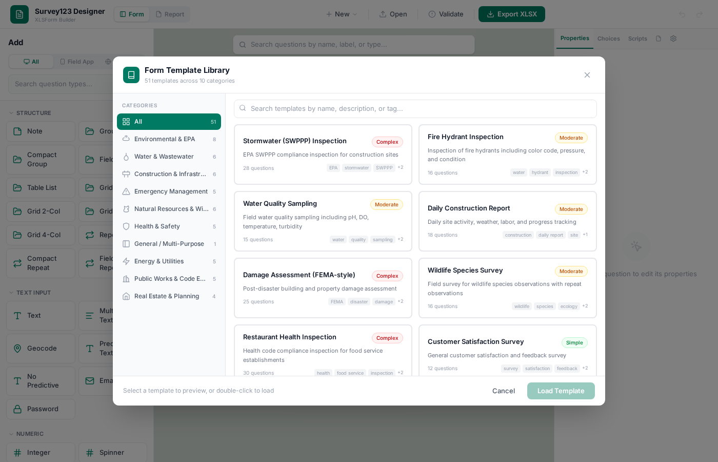

51 pre-built form templates across 10 industry categories (Environmental, Water/Wastewater, Construction, Emergency Management, and more). Great for getting started quickly or seeing how different form patterns work.
Template library with category browsing, search, and complexity indicators

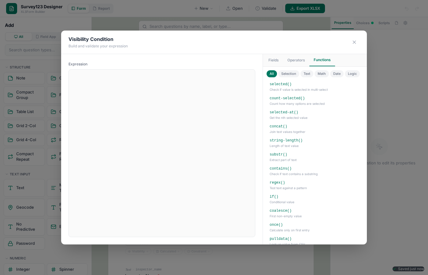

Visual expression builder for relevant, constraint, and calculation expressions. Instead of hand-writing XPath, you get a field picker, operator palette, and categorized function library.
Expression builder with field references, operators, and function library

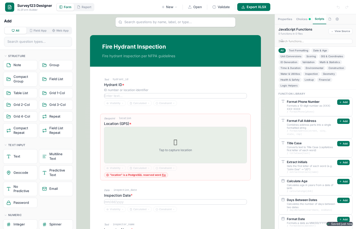

JavaScript function editor with 85+ function templates across 17 categories (text formatting, date/age calculations, GIS/coordinates, scoring, unit conversions, and more). One-click add generates the pulldata("@javascript", ...) expression for you.
Built-in function library with syntax highlighting and in-browser testing

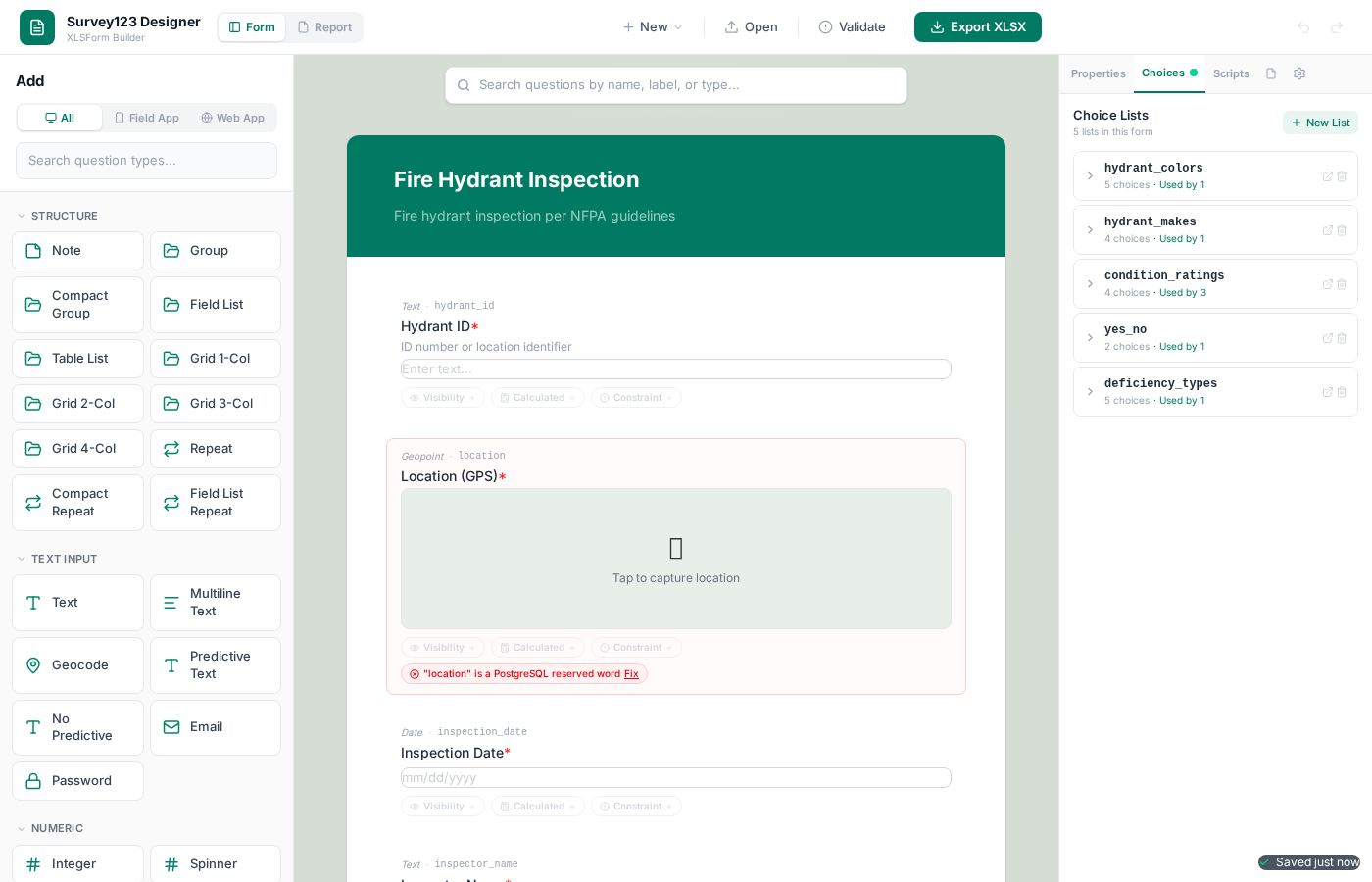

Choice list management with inline editing, drag-and-drop reordering, and a pop-out modal editor. Plus a cascading select wizard that walks you through setting up filtered selects visually.
Choice list editor with shared lists and usage counts

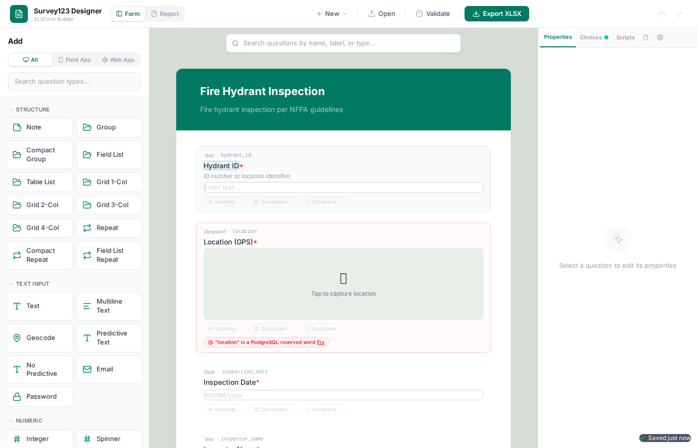

Form validation catches issues before export: duplicate names, missing labels, orphaned choice lists, broken expression references, unmatched groups, and reserved word warnings.
Validation results with inline error indicators
