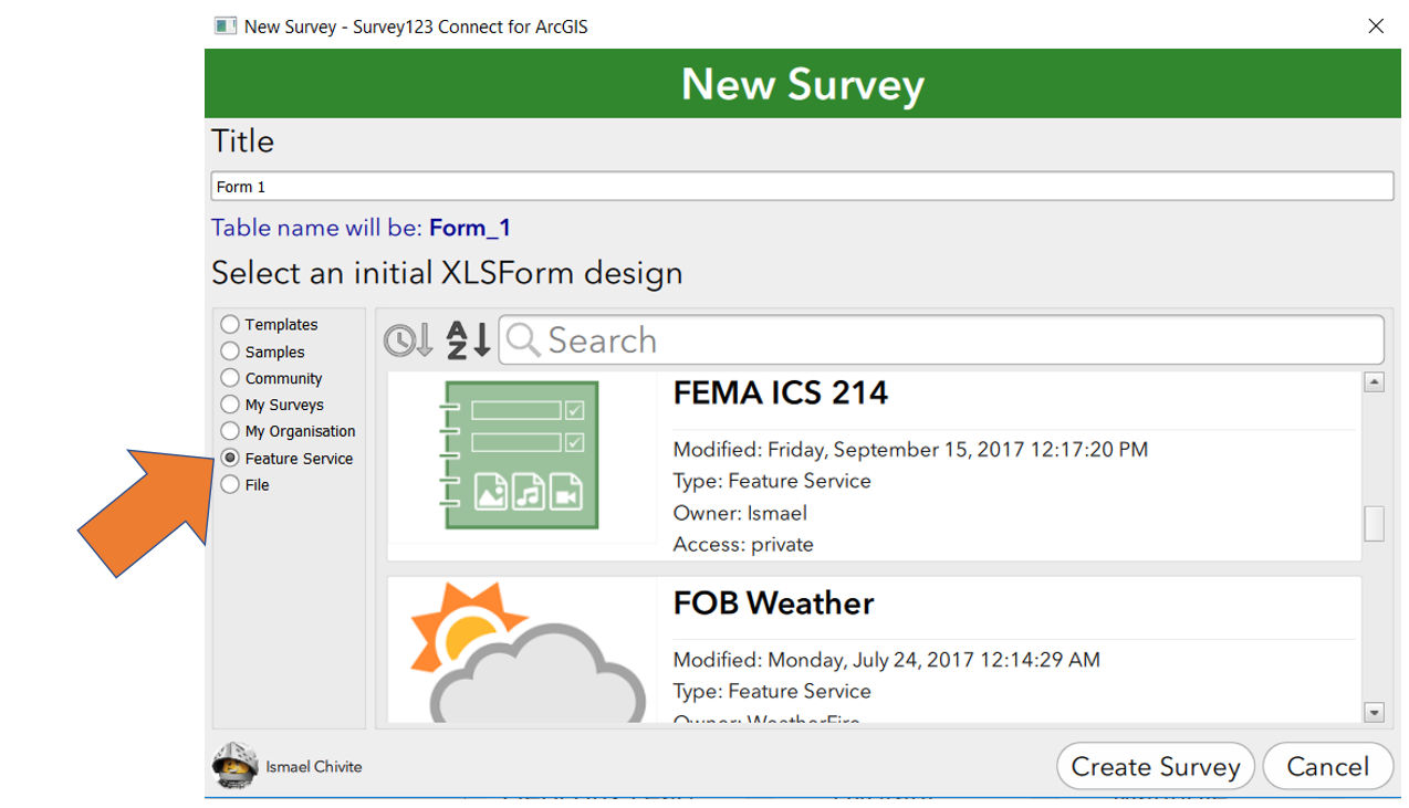

  • 0) Look for your existing feature layer item in ArcGIS.com.  It will likely be within a folder that Survey123 Connect created originally to host your layer and the Form that is now lost.  Move the feature layer to your root folder in ArcGIS.com. Then DELETE the old folder, which should be empty. If you have any other things you want to keep, move them away from the folder before you delete it.
  • 1) In Survey123 Connect, create a new survey on top of your existing feature layer.
  • 2) You could recreate your survey from the new survey created, adjusting the labels, adding the groups, appearances and other things you may have had in your previous form.  Alternatively, if you still conserve the old XLSForm, continue with step 3.

MikeOnzay
Hi Ismael,
I was able to recreate the form item using your steps. My survey dashboard is back. Thanks!!!
