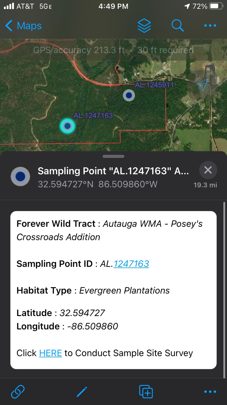

The Pop-Up is as follows:

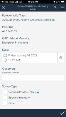

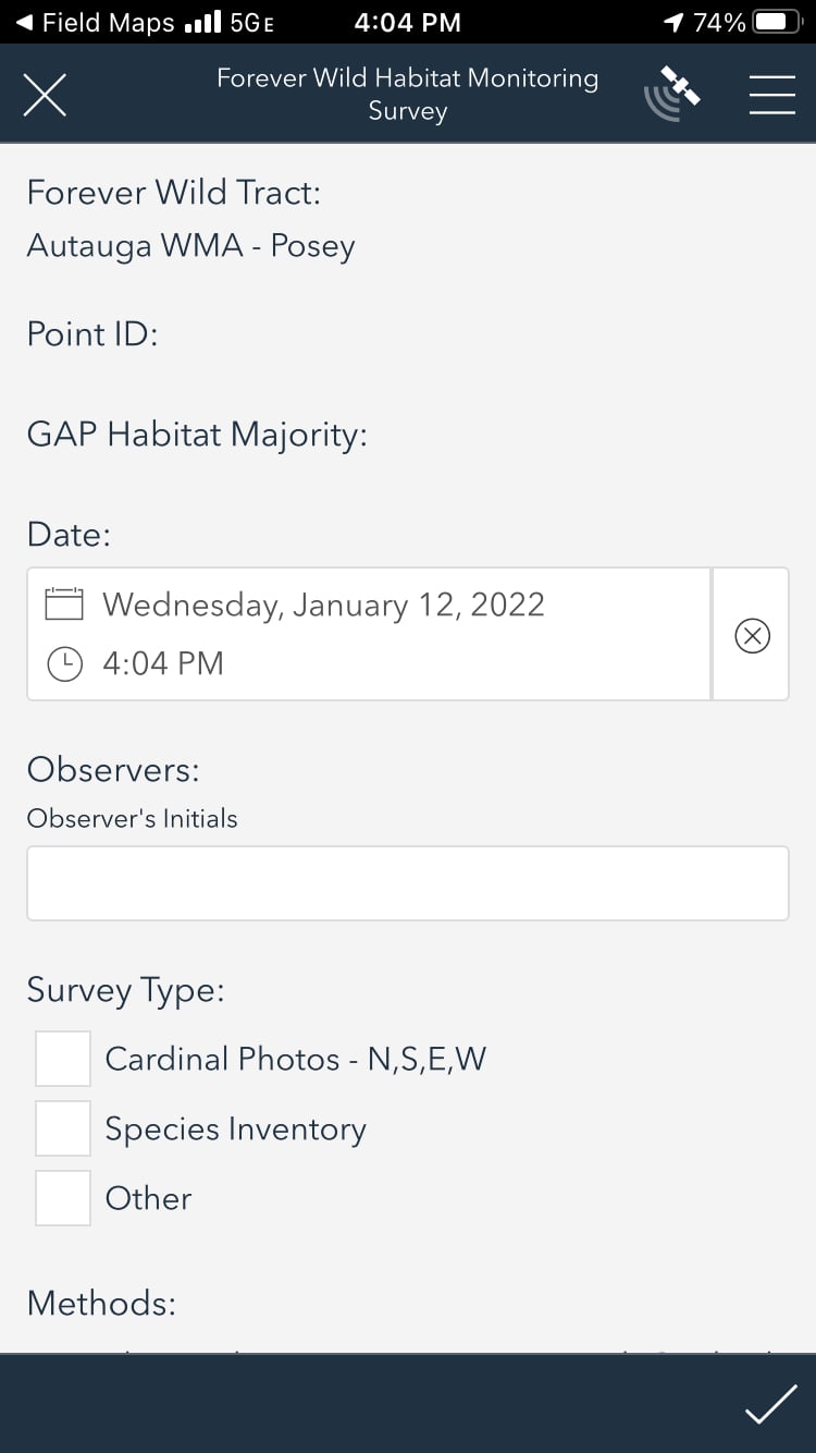

But.... When I click "HERE" to link to the survey, the Survey looks as follows.
You can see how the Tract name after "Posey" is cut off and then no additional auto-populated information is available in the survey (Missing Point ID and GAP Habitat Majority-autofilled questions). However, it was only 2 points exhibiting this type behavior. All other habitat point surveys that were opened would show the auto-populated information: the tract name, point ID and GAP Habitat Majority when opened in S123.
I deliberated on this issue until I tried removing the apostrophe from the tract name. Consequently, the survey/field map work flow worked as it should, at the compromise that the tract name is no longer reflected correctly in the pop-up or in the related records. My big question- Is there a work around for this issue? Has anyone else ran into this? Clearly apostrophe's don't have a place in this work flow so is there any way this is a bug? I'd like to reiterate the point that the rest of the workflow works with no issues, for the exception of the two points that occur specifically on this Forever Wild Tract.

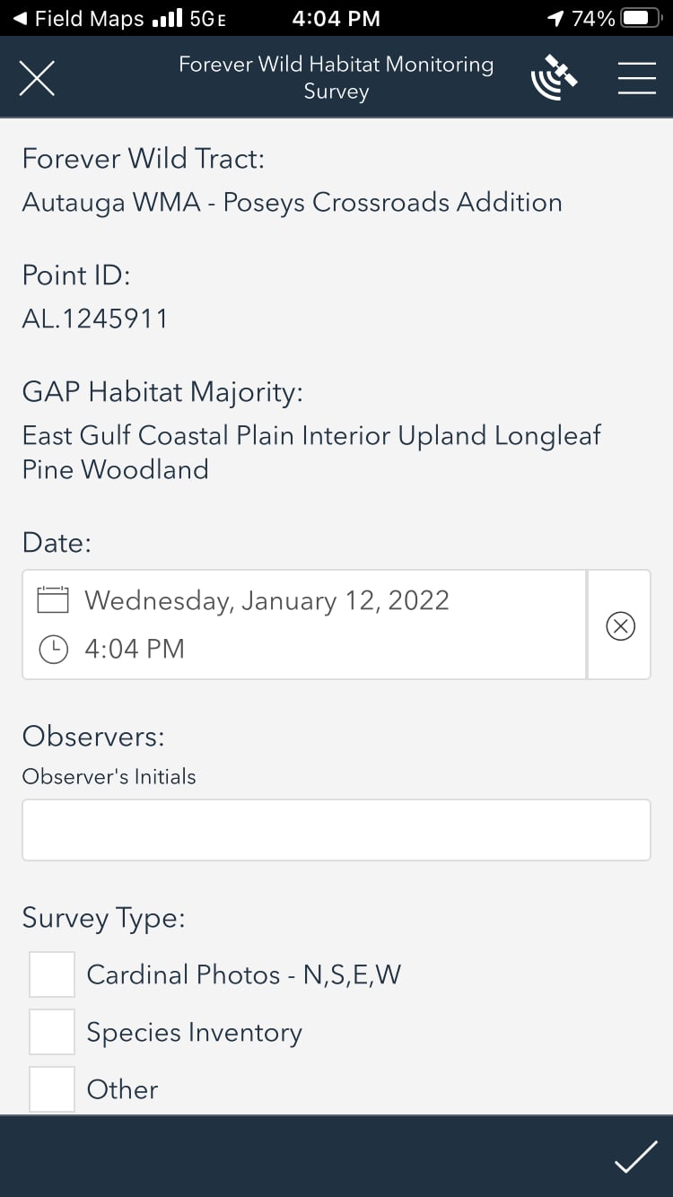

When I change the tract name of the feature to "Poseys" instead of "Posey's", the form is autopopulated with no issues. Note: Habitat majority is different in this screenshot but it is still a point that occurs on the same tract with the tract name in question.

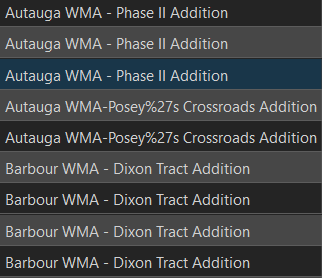

I got the pass through to work once I included encoded values in my feature layer as you can see in this picture.
While now the survey opens with no issues and looks as it should, I'm running into an issue where my pop up reflects the encoded value of the layer.
When I click the link to open survey, everything appears fine.
My big question now is, how can I code my pop-up to replace that hex code with the actual apostrophe? I'd like to avoid going as far as creating a whole new tract_name field as an alias field for my pop-up. Is there a work around to avoid doing this?

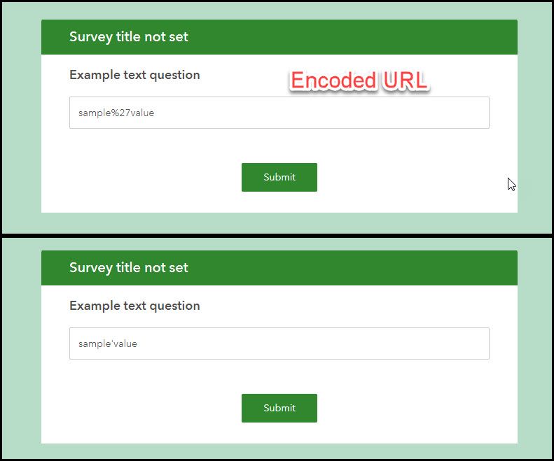

One way to do this is to use an Arcade expression to encode the attributes that you want to pass as parameter in your custom URL and use it in your pop up. Below is an example:

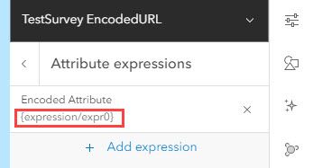

1. From the pop up section, open Attribute expressions

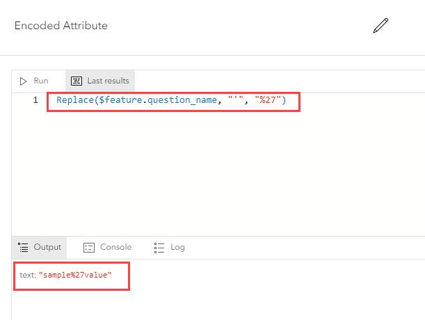

2. Add an expression to replace any characters in your attributes that need to be encoded. For example, use an expression like below to replace ' with %27:
Replace($feature.question_name, "'", "%27")
3. Note the expression id, in this case: {expression/exp0}

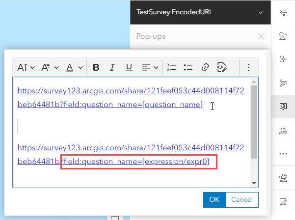

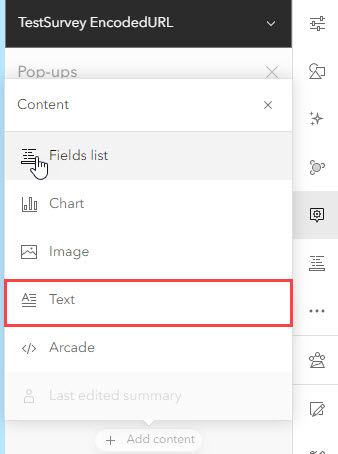

4. Add a Text element to your pop up
5. Replace the field name with your expression id in the hyperlink to open your survey form and pass the encoded attributes. In the example below both URLs are included for comparison. First URL uses the actual values from the field and second URL uses the encoded values.

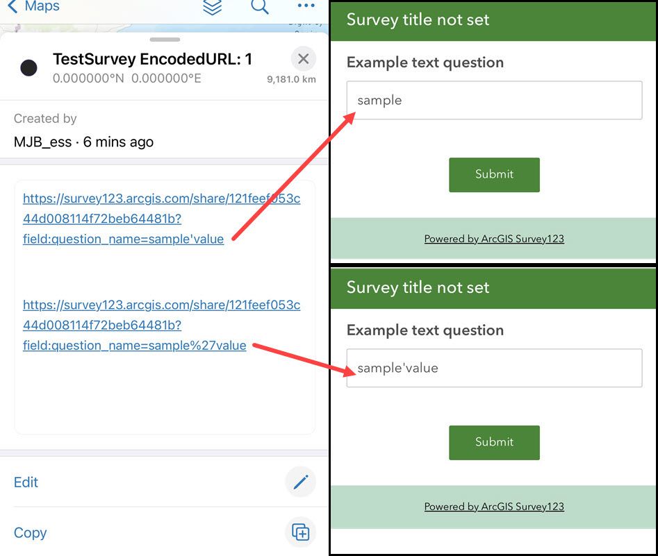

6. Now, when the survey form is launched via the second URL in Field Maps app on a mobile device, attribute values are passed to the survey question as expected. Notice that when the first link is used, the attribute value is truncated after '.
7. As I mentioned in my previous post above, this only works in field apps. For example, if you use the same link to launch your survey form in browser from Map Viewer, the first URL with actual values shows existing values as expected but the second URL shows the encoded values as a string.
