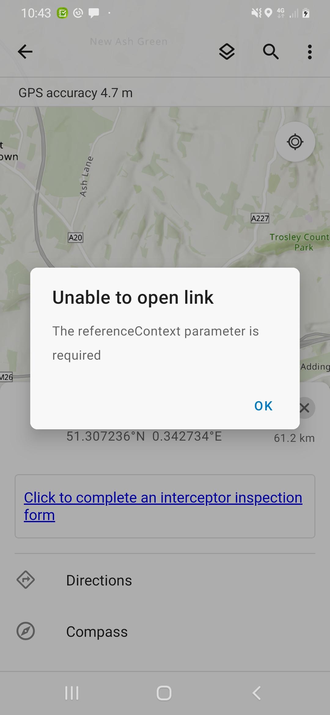

Also once the users have completed the form and gets sent back to the Field Maps app, they are receiving this error message:
Does anyone have any idea where i've gone wrong please?
cat206
Hi All,
I needed to add in the ?referenceContext=open into the URL but i was getting an Unpacking error. I've found this post Solved: Custom Survey123 URL with Field Maps Callback - Esri Community
I used the about ecoding website and followed the solution by encoding the callback URL:
https://fieldmaps.arcgis.app/?referenceContext=open&itemID=ecd711f706fb4842a08ba6e74c1a1af2
into this:   https%3A%2F%2Ffieldmaps.arcgis.app%2F%3FreferenceContext%3Dopen%26itemID%3Decd711f706fb4842a08ba6e74c1a1af2
And its finally worked! Hooray
