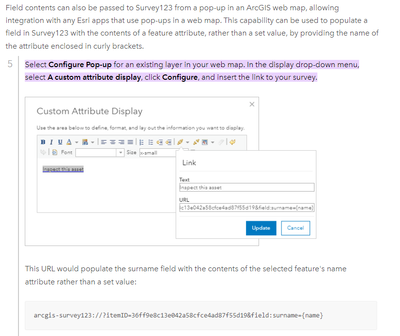

You can configure the pop-up in your field map to include a link to launch the Survey123 inspection at each location so that it seems like they are working in a single app. You can also transfer the address from the point in field maps to the inspection submitted in Survey123 using URL parameters.   https://doc.arcgis.com/en/survey123/reference/integratewithotherapps.htm#:~:text=Select%20Configure%....

You can do that using URL parameters. Your URL would look something like this:
https://survey123.arcgis.app?itemID=(Item ID of the field map point layer),&field:(name of the field with the existing data that you want to transfer)=${(field name of the question in survey123 you are populating).(attribute name)}
This is what one of mine looks like:
https://survey123.arcgis.app?itemID=5fa850838bdb4578934&field:WorkOrderID=${assignment.workorderID}

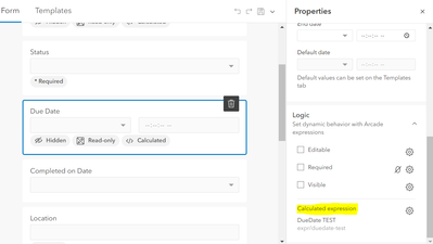

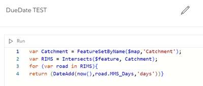

Do you have access to a point or parcel layer that stores your address information? You could create a calculate expression for your 'address' field in Field Maps that populates the field with information from one of those layers. Not sure if there is another way to accomplish what you are looking for.
In my example, I automatically calculate a 'DueDate' field using an arcade expression that gets information from a polygon layer that intersects with a newly added point in field maps.
