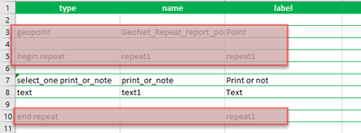

3. Go to survey tab -> delete all fields outside the repeat Ruth_JiatengXu_0-1625541930882.pngRuth_JiatengXu_0-1625541930882.png
4. Publish the survey, and you will have the survey with every repeat instance as a record.
