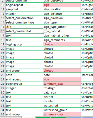

Here is the xls form.

Yep big red errors right there.  123 really does not like when you name things the same.  Need to change these. It may publish but like you are seeing it comes back to get you.  In theory this should be ok since its just groups. but good to start there.  I do EndSignGroup like that.  The red and green errors mean something, cannot ignore them.  (except for select one of course that always does that)
I also would change the list names to like signList (mostly an issue in older 123 but still best practice).

I made the changes but the survey is still resulting in the same error message.

Including the XLSForm with very minor modifications. I simply removed the duplicated names and published as a new survey.
