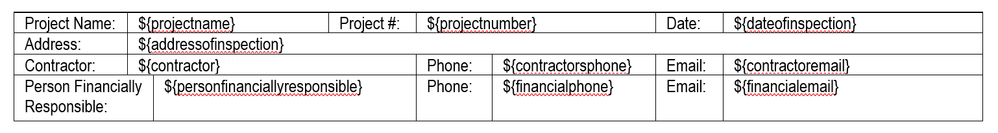

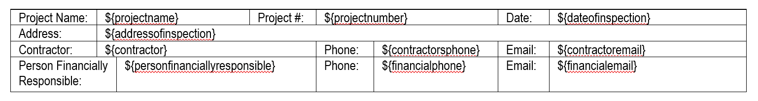

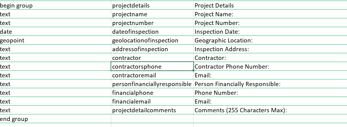

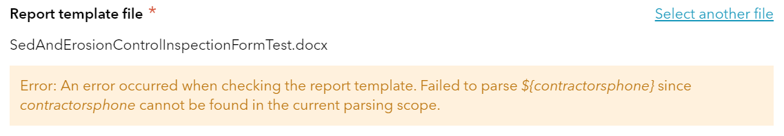

I am trying (for my first time) to create a Word template for an inspector here in our organization, for Survey123 in our Enterprise/Portal environment.  However I am getting a parse error for ONE field that matches everywhere it should.  I was hoping to get some feedback from those of you with more experience on how I can correct this.  I have included screenshots of the portion of the survey in Survey123 Connect, the Word template I'm trying to build for the inspector's use in notifying those needed, and also the error I received when trying to upload the template to the survey.

Have you tried using the Create Sample Template button under the Manage Templates window? I've always found that very useful for troubleshooting. If the sample template works OK maybe you can identify any differences in closing and opening tags and things like that.
Also it might be worth posting more of your xlsform and template here in case there are additional complicating factors that aren't apparent from what you've shared so far.

This is an error I get commonly when I have missed the opening or closing of a (possibly nested) repeat in my report template. I don't see any repeats in what you've shared though, so my only guess would be that it is possible the ${contractorsphone} field was added to the survey form, but the updated form itself hasn't been published yet. If that is the case, I believe that a template with the ${contractorsphone} field wouldn't think it is in the form schema, even though on your XLS (and even Survey123 Connect), you can see the field.

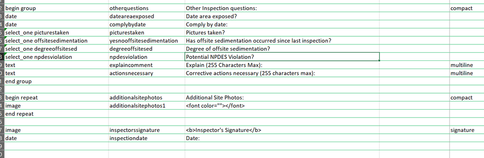

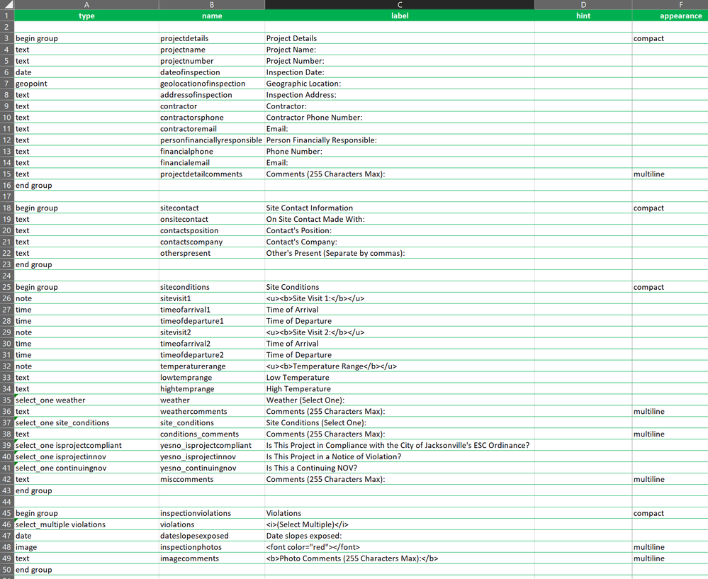

I'm attaching two screenshots of the full survey in case that helps either of you see any blatant mistake I've made in the form that could be affecting this one field when uploading the form template.
Thanks!
