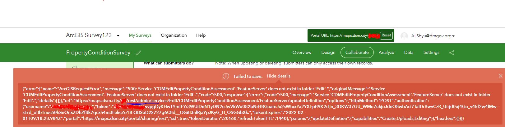

I'm trying to change the setting to where submitters can "Only add new records" but I'm getting the following error.
I believe is because the URL is wrong, it has  ADMIN in between rest/services/(folder name)/(service name). Where can I go to update the URL?
The survey was created using Survey 123 Connect 3.13.251Survey123Error.JPGSurvey123Error.JPG

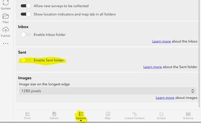

I think I found a work around. In Survey 123 Connect under "Options", I disabled "Enable Sent Folder" option and that solves my problem of editing and deleting surveys.

Hi @AliciaShyu,
Is this a new error, did the same survey work previously? Did you change anything recently or publish with a new version? You should not need to change the URL, it is created based on the portalURL appended to the survey123 website URL when you enter the portal or use a link that creates it.
