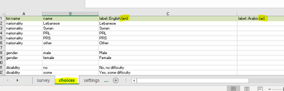

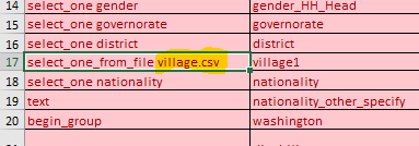

Hi Ahmad,
You are missing the file name type for the village.csv in your XLSForm and also missed the language code in the choice tab.
Please try this XLSForm and it should work with current 3.12 production build.
