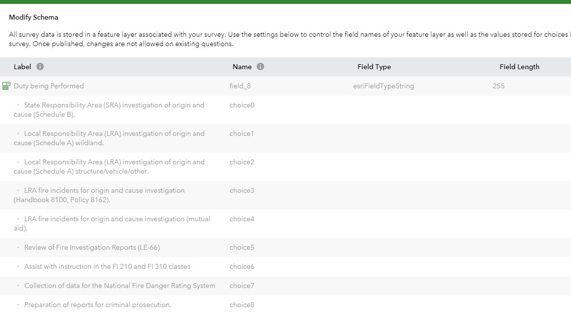

JohnPlunkett
Hello - not sure if this is what you are after - but I worked with a customer with a similiar issue - waht we did was before publishing the Survey when using the designer we changed the Schema before publishing
So you change the choices and fields to what you desire

What did you change in the Schema?
I am getting the Name not the label, and the Name does me no good...
