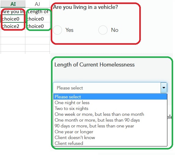

I have created a survey using Survey123 Web, submitted a couple of test forms, and exported the data to CSV. In the output, I see values like choice0, choice2, choice4, etc. instead of the actual choices as in the form. For example, for "Are you living in a vehicle?" question, the possible answer are Yes or No. However, I am seeing answer "choice0" and "choice2" in the output. Same for "Length of Current Homelessness" question - "choice0" instead of actual options from the form.
Is this a known issue? How do I get actual values to show up? The Analyze tab on the website shows actual values, so I know the data is there...
