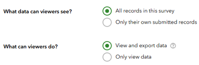

4. In Survey123 Website - Collaborate - Share Results settings:
When the organization member goes to Surveys I can view results for, he sees the survey. When opening the survey and clicking the Data button, the export feature is disabled.

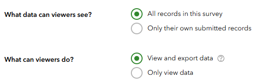

SaadShahzad
We noticed this issue as well, our user types have not changed but now we're noticing the Export option grayed out even though the settings are enabled on the survey/and the feature layer.
