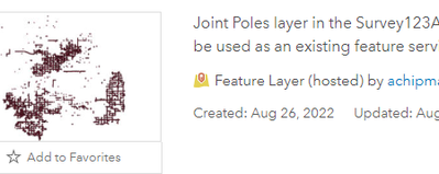

I've shared it as a Hosted Feature Layer.
I've read through the documentation enough now that I'm confused - does it need to be a hosted layer in Portal in order to work with Survey123?
