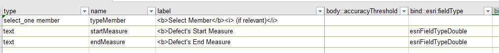

I have set my measurement entry to esriFieldTypeDouble (see below) but that does not seem to do anything.
I can type in characters into the field instead of numbers and it was validated - and it shouldn't isn't it?

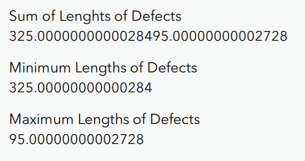

On another topic, I want to set these measurement fields to enter numbers with 3 precision. How can I apply the restriction? Same with the min/max/sum(${repeat_questions}) - I cannot work out how to set the precision to the calculations:

Hi!  The bind::esriFieldType column is used to define the type of field that will be created in the feature layer of your form once it is published from Survey123 Connect. This is an optional (an advanced) column that is typically used when you want to overwrite the default field types mappings chosen by Survey123 Connect. There is more info about this in https://community.esri.com/groups/survey123/blog/2015/08/24/xlsform-mappings-to-arcgis-feature-servi...
In your case, it does not seem like you should need to use the bind::esriFieldType column. Instead, you may want to simply change the type of  your question to either integer or decimal.  By doing so, the user input will be filtered so only digits can be entered.
Since ArcGIS only supports 32bit integers, using the decimal and integer type of questions will limit the length of the numbers people enter.  If this is a problem to you, you can keep the type of question as text, and then change the appearance of your question to be numbers. This will bring a digit-only keyboard into the device when the user wants to enter  the number, but will actually persist the user-input in the feature layer as a text.

I have an issue with summing the repeats however. As you can see from my first posting, the results from the summation shows up both of the repeats' results instead of summing them up.
Did I have the formula wrong with the sum${repeat_questions} ?

What is the field type of the field in the repeat, is it integer or text? If it is not integer you can not sum it, as it will concat it if text, so need to set the bind type to be integer.

It appears you are using reserved keywords in your name column based on the screenshot. As per the documentation and xls form template for Survey123, reserved keywords can not be used for fields or choice lists. If you open the xls form and go to the types sheets, you will see the full list of reserved words that can not be used (from row 177 onwards).
Please make sure none of your surveys are using reserved words. Once you have updated the name and republished the survey, let me know if the calculation is still not working as it could also be related to the repeats and note fields, please share your xls form to take a further look.

You are using note fields to store/display the calculations. Note fields (as the name suggests) are text fields and the App and ArcGIS online treat them as text. Therefore calculations that involve numbers only will still be treated as text and hence concatenated, not summed.
To resolve this issue, you can either change the type for these questions to decimal (not note), or set the bind::type parameter to decimal. The bind::type parameter applies to the App, whereas the bind::esri:fieldType applies to the feature service field. If you are using text fields but want them to be treated as numeric fields in both app and online, you need to set both correctly.
