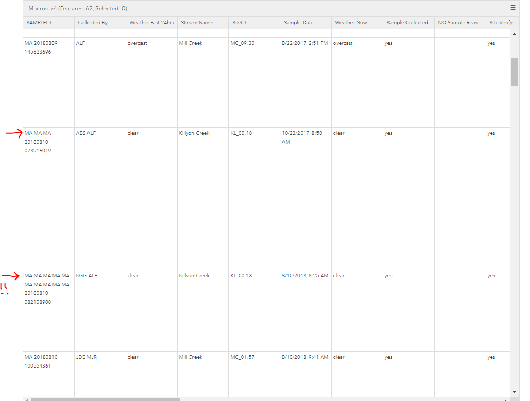

We are generating unique sample id's based on the following calculation:
concat('MA ',once(format-date(now(), '%Y%m%d %H%M%S%3')))
It seemed to have been working just fine, until I noticed a couple of funky ids, where the concatenated "MA" is being added multiple times!  (see screenshot).  Any idea what's going on here?

Hi Lynn,
It certainly appears that the concatenation occurred multiple times, though I would also expect the data portion to have been repeated as well.  I noticed that these were collected on August 10th; a bit after that, a hotfix was released that changed the behavior of calculations when opening surveys from the Inbox (see https://community.esri.com/groups/survey123/blog/2018/08/16/minor-update-to-survey123-available-augu... ) - does this occur with any later surveys?
