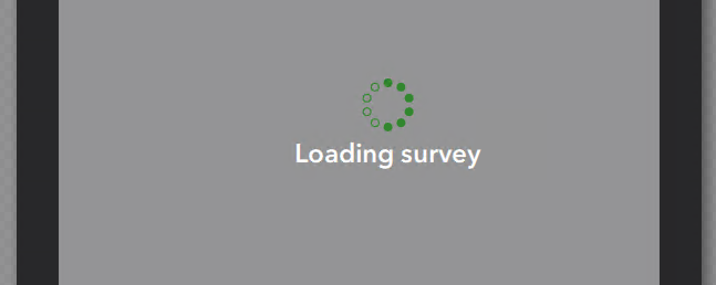

Hello,
I started seeing survey loading & updating errors while using Survey123 Connect v.3.12.230.
Once I open or save a xlsx form to update forms, it's hanging for long - like hours and I had to force it shut down. I tried to find log files but the folder seems empty.
This started happening yesterday while I was working on second survey of the existing feature layer that includes a repeat group, and now it appear to all surveys.
Can someone direct me how I can isolate where the issue comes from? I've also tried to update the Survey123 Connect to the version 3.13 but there was an installation error - installation window disappeared in the middle of installation (about 60%).

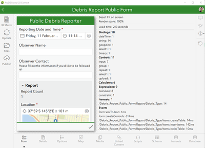

Hi @KerryKang,
Having a look at your XLSForm, it is actually a very small, simple survey, with nothing complex that would slow it down. On my Windows 11 Surface Book 3 the survey opens/refreshes in 2.5 secs in Connect. See below screenshot.
It sounds as though the remote desktop session you are running Survey123 on is having an issue (is it a VM or physical machine?). The Survey123 installation could be corrupted or some other resources and/or memory on the remote desktop session are causing issues with Connect.
As mentioned above I would suggest to restart the VM or physical machine, try and uninstall Survey123 Connect and field app completely, and install the latest 3.13 release versions. You can also try with the 3.14 RC versions available from Early Adopter Community which will be released soon.
