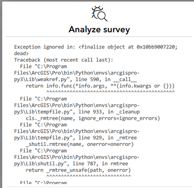

Hi,
Just wondering if anyone else has had issues recently using the Analyze Survey tool in S123 Connect? Both myself and my colleague are getting the error below when running the tool on any new surveys created. This includes just a basic survey with the standard example questions included. On previously created surveys it appears to work fine. We have both had ArcGIS Pro 3.4 installed recently so I wonder if that is causing the issue with the python library. If someone could look into this it would be much appreciated.
Thanks
Anthony

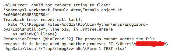

Thanks for raising the issue. The upgrade to ArcGIS Pro 3.4 is indeed the cause of the issue. We have logged this as BUG-000173134
A workaround has been identfied:
  • In the survey's .xlsx form navigate to the Version tab. Modify the template version from the function to the value of Connect being used. For example, change "=TEXT({3.21}, "0.00")" to "3.21"

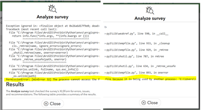

Yes, I am getting something similar.  We are on Enterprise Portal version 10.9, Survey123 Connect version 3.17 & Arc Pro version 3.3.
abureaux
MVP Frequent Contributor
@AdministratorWellington_Water  In your case, it looks like the XLSX file may be open. The file needs to be closed for the tool to run successfully.

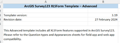

JayHodny
I see similar 'exception ignored.....' output , then a message "Results....No issues were found."  I opened the XLS Form.....Version tab, and see this.  There is no function statement to change.  I am not sure what to try next?
