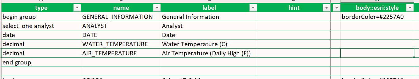

body::esri:style with a fixed-grid survey
496
02-14-2025 08:24 AM
tmichael_wpjwa
Is there a known limitation with using something like borderColor="red" in the body::esri:style field in a survey group that is configured to use the fixed-grid style?  Setting backgroundColor here seems to work, but borderColor does not.
I'm using Survey123 3.21.62

Yea I reported this a few years ago now.  See here for my workaroundish.   https://community.esri.com/t5/arcgis-survey123-questions/theme-grid-lines/m-p/1058133

Ah, thanks.  I did some searching before asking the question and didn't come up with anything similar.  I went ahead and kudo'd the idea (from 2019...) so maybe it'll be added in the future.
DougBrowning
MVP Esteemed Contributor
My trick in there to color the labels worked out ok in the end.  Have to be careful on color choices when out in the sun though.
