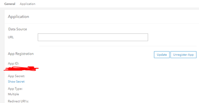

Hey,
So im trying to get values from my questions. But whe i use onQuestionValueChanged, i get the following error: the event, survey123:onQuestionValueChanged, is not allowed with the clientId.

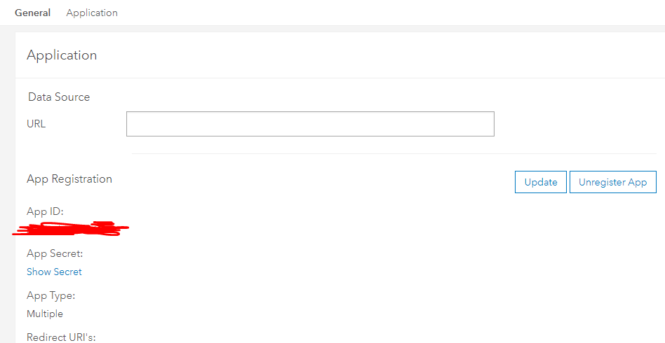

for the clientID i made an application in my portal and took the appID.
let webform = new Survey123WebForm({
	itemId: '',
	container: '',
	clientId: '',
	portalUrl: '',
	onQuestionValueChanged:test,
function test(data){
	if(data.field === "untitled_question_1"){
		console.log("value changed");
		console.log(data);
do i miss something? Thanks for helping.
