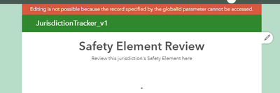

This URL  <https://survey123.arcgis.com/share/0b3887da838e453f8da75f66b2e937a1?mode=edit&amp;globalId={GlobalID}> yields this:

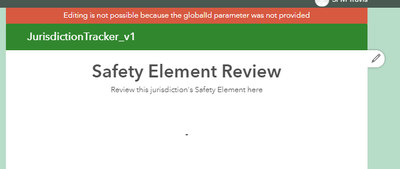

...and this URL <https://survey123.arcgis.com/share/0b3887da838e453f8da75f66b2e937a1?mode=edit&amp;JurisdictionId={Gl...}> yields this...
...and this URL <https://survey123.arcgis.com/share/0b3887da838e453f8da75f66b2e937a1?mode=edit&amp;globalId={Jurisdic... yields he same as above.
What was unclear to me in your workflow was what relationships your related tables had to the parent (1:1 or 1:M). I understand from your post that you do not seem to think you should start from the feature service but I can't really see why not. The workflow seems more or less the same, unless it's in how the relationship is configured. In either case you have a survey and point it towards a new item. The issue here is how to edit a record in a 1:1 related table.

I wonder if you are in the parent popup but want to edit the child?  If so your URL is sending the parent globalid when you prob want the child globalid.  If so I have some arcade code that uses feature set to do lookups into other layers.  So basically go find the child globalid then pass that in the URL.  Let me know if that is it.

I was stuck just trying to get the parameter to work, but I just added a field to the feature service and calculated over the child's global ID. Since it's 1:1 this shouldn't cause any issues. Now I just feed the URL globalId={ChildID} and it does the job just fine.
